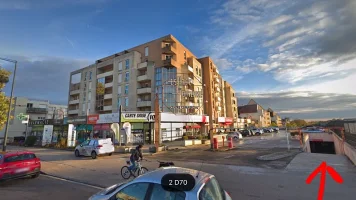

The problem is that there is a residential building, and a shopping center.
So as soon as the angle grinder would make its first rpm, the police will arrive :whistle:
