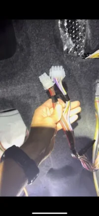

I had to move my sargent ec155 power unit because it will be in the way of the furniture units being fitted.
I haven't been able to pass the 240v and 12v harness through the pillar as the clip is too big, I've been advised that this needs to be cut, thread through and rejoined. This is being my comfortable capability so I've been trying to find a company to finish the job for me (and wire in a fridge.)

Photo is how it currently looks.

Can you post a picture of the plug/clip the wires run into? most of the time there is a release system built into the plug either by inserting a pin to release the wires, or a plastic lug within the plug that you push out the way

As above post some pics of the offending clip/plug.
@SamD Apologies not the best image I'm not at my van right now so this is grabbed from a video. Here's a link to the kit used:

Those look like the pins should come out pretty easily?
Do you have an tools? Or sometimes an unfolded paper clip can work.

Aslong as its all disconnected its very easy, just shove a pin inside the plug where the wire is and that releases the wire.
You dont need to visit a specialist conversion company just see if you can find a friendly local garage as they will have the tools to do it, shouldn't take long at all.
