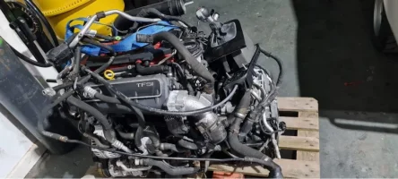

RSQ3 engined

One I got was the 2012 t5.1 2.0 bi turbo dq500 hopefully holds similar torque
