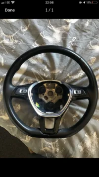

Hi people
Hope everyone is safe and well
Does anybody know what airbag loom i would need for a mfsw which has no cruise buttons on the left
Any help would be much appreciated
many thanks

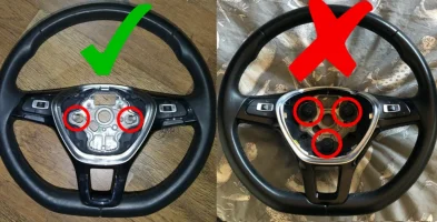

1st observation is the airbag mounting method differs to the '2 hooks' when will be found on the T6 so the stock airbag you already have wont work with this wheel, Do you have the airbag to match the wheel and if so what loom does it have?
i seem to recall that button config has been retrofitted on the T6 in the past so hopefully someone else will be able to confirm.
