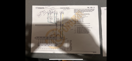

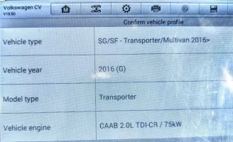

My mechanic has VCDs. I didn't know you could honk via software.
There is something in the back of my mind that this happened on my mates T5.1 when the battery went completely flat. The fact you have lost everything sounds like it has lost the coding.

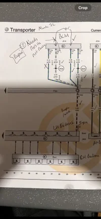

Looking back at my notes, there should be a white / grey wire from the coil spring to the BCM that connects to location 36. I can’t remember if my note above meant that I had to make a cable. Sorry I can’t be more use.
Ran some checks today and got two different codes
I checked all the codes and they were in place. Still no working horn or MFSW volume up/down.
