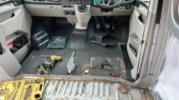

My first stop was to get rid of the bulkhead which was easy, until I realised there was an angle grinder requirement to remove the fixings. A good opportunity to develop those practical skills I said I was lacking! Out the metalwork came with a real sense of achievement and all 10 fingers still intact. I rerouted the cables under the passenger seat whilst doing this and learnt that putting the handbrake back together is a nightmare - I have ADHD and so I have a tendency to do something, think its fairly simple at the time, and when I come back to it I've completely forgotten every step.
