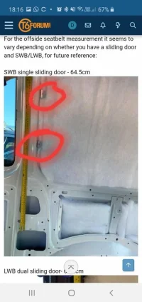

Sorry for jumping in this thread. Not looking to mount seatbelts but needing the parts highlighted in the picture below to mount the rear ply panel to. Anyone have any idea where I could get them or have a part number for them? thanks!
Pick them up from your local VW parts dept. :thumbsup:

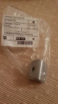

Here's some part number knowledge for you:
