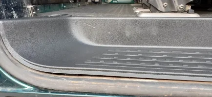

I'm in the process of converting my van to a 9-seater. I put the rubber floor in today, but obviously it's sticking up above the sliding door instep. Do I get a Kombi or Caravelle side step (I know they're deeper than panel van ones) so it sits flush over the floor? And what's the part number please? Cheers.
If it's the standard oem kombi rubber floor you have used, i would go for the kombi step.
While the caravelle step could be used, it has extra locating tabs at the front and rear of the step designed to locate inside the wider caravelle B & C pillar trims. They will be exposed in your van......looking a bit out of place!
As for part numbers, sorry I can't help with that bit!
Thanks foggy3061 I'll get a Kombi step. Are they quite easy to put in? Do I have to take up the rubber flooring on that side to enable the fitting?
They're a straightforward fit really, just line up and push down into place. You don't need to move the rubber floor.
If your replacement step has a light, fit the light and wiring before you fit the step as they can be a bugger to remove again once clipped in place!
Not sure if that's a fair price or not!?
My only frame of reference was a new kombi step with light but it was dearer than that.
Maybe measure the depth of your current step and ask the seller what the depth is on his step?
Yeah good idea. I asked elsewhere in the forum but don't think I got a reply. Do all Kombi steps come with a light or can you get one without? Not too bothered about it you see....
Sorry for the delayed reply @Sandyman!
I think they are available without a light......you've probably found one by now i guess! :D
Thanks yes I have! It did come without the light but I now have a rectangular cut out in the step...hey ho you can't have everything! It fits nicely apart from the bottom left horizontal step...I just can't work out how to get it to clip in underneath and that's got me thinking that I need a deeper Caravelle one, but this is from a Kombi so must be the right one as I've laid the stock rubber flooring mat. I'm a bit puzzled! IMG20210308162813.jpg
