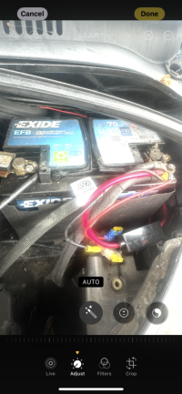

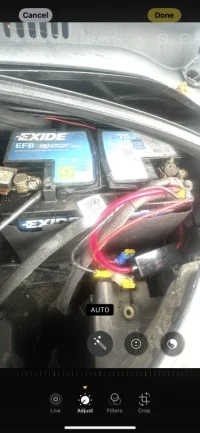

A couple of pictures of both batteries if possible also helps folks advise.
Hi, the battery was changed as the in van display said shutting down as battery low. The leisure battery is showing fully charged.
I don’t know if they reset the health data - the mechanic said when they checked it said ‘replace battery).

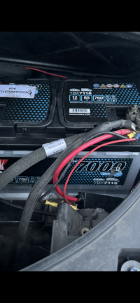

The exude is the old battery and the other one the new battery - I noticed the Ah are different!
If they didn't recode the van then most likely your smart alternator is charging to the level of a knackered 70Ah rather than a new 85Ah one.
Normally you would have (in the BCM) changed the capacity and then changed the serial number to reset the health data. That's normal for any smart alternator Transporter, nothing specific to it being a camper.
If that's your issue the BCM should self learn in about 10 complete charge cycles.
Can you check the real van battery voltage rather than use the Sargent control panel?

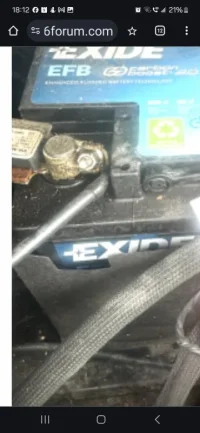

The negative directly to the battery post is a big no no in a vehicle with a smart alternator and a shunt. All charge flowing down it will be unaccounted for by the BCM so it will think the battery is far more charged than it is, leading to a flat or badly charging battery.
It looks substantial, if it's for charging your leisure battery that will almost certainly be your issue and may have been the issue that caused the damage to the original starter battery. You need to determine what it's for.

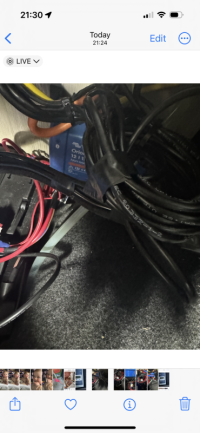

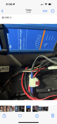

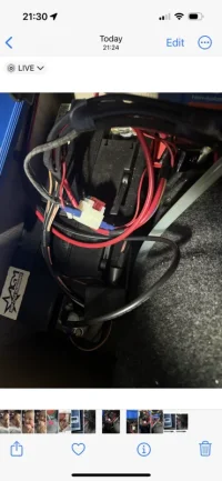

My concern is that they have wired a negative feed to your Orion - pictures of that area would help.
An I do that via a normal volt meter - what am I looking for as a good voltages d does that tell me how charged it is?
Where does that heavy black wire from the Orion go?
I was half expecting to see the isolated version with 2 negative black wires.
Hi,
Just had a look and it disappears behind the trim - so don’t know where it goes.
I’m hoping the garage did not reset the health data and higher battery capacity and that sorts it (as that sounds the easiest fix).
Yes, that's my worry. Looks like someone has both bypassed the shunt and wrapped up a red lead in black tape...
@Paul Sussex regardless of if the wire we are talking about is the source of your issues it does need moving as where it is is going to be constantly throwing out the the van's battery management.
It needs to move to a good ground in the engine bay at least. If it does indeed go to the Orion then that actually doesn't need to be wired to the battery negative terminal, it just needs a good ground. There is presumably one near the leisure battery.
