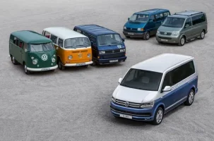

T 32 is the weight capacity- T32 being 3.2T, T28 2.8 ,T30 3Tonne. T6 is the model of the van, so you can buy a T6 in different weight capacities. Hope this makes sense!

Also to add further confusion, each model gets a sub-version moniker when it has a facelift. So you’ll come across a T2.5. T5.1 T6.1
