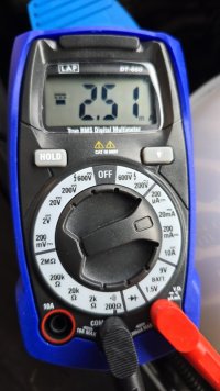

Evening all, hopefully someone can help me. I have recently had my van converted, since then it keeps going flat. I have trawled the internet trying to find an answer and I am still non the wiser.

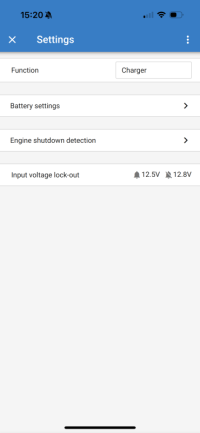

When I went for my conversion I wanted a LiPo battery for longer battery usage, I also had the Orion smart charger fitted. I was told by the convertor to avoid a flat starter battery that I would need to find a sweet spot on the Victron Connect app to suit my van as the VW smart alternators vary from van to van. However it does not matter how much I alter the settings I cant stop the van going flat. My starter battery goes way below the shutdown voltage setting on the app.
Currently the app is set to smart alternator.
Start Voltage 14.00
Delayed start voltage 13.30
Delayed start voltage delay 120s
Shutdown voltage 13.10
What I was wondering after watching a lot of YouTube and scanning the internet was, am I missing a component. Is the smart charger compatible directly to the LiPo without any other components?
Secondly I can only connect to the battery through the Victron app if the vans engine is running, is this normal?
