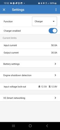

I think I had the lockout setting higher than the battery output voltage due to a faulty battery. Hence why it wasn't visible when it wasn't running.

Afternoon, i have just checked the orion imput and there's a constant 12v feed. However the LED statuses are different when running and not running the engine.
Engine off flashing Bluetooth light and no green power light.
Engine running solid Bluetooth light and solid green power light.
Any advice on this please is this normal? Is this why I can only connect the app when the van is running.
What rate is the Bluetooth light flashing at?
There is a ton of info in the manual for troubleshooting and light status. Also detail on input lockout. Online version available here:
Orion 12/12 non-isolated manual
