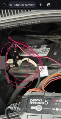

Id image the center pin wasn't touching the rear of the 12v socket.

So got home, connected the charger to the battery with the crocodile attachments and still nothing apart from the standby light??? vans battery is fine as i kicked it in just to make sure, am i still doing something wrong???

You need to move those need connections, and the charger neg over to the light bracket.
