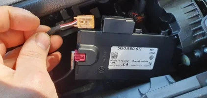

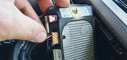

Swapover completed.
Very happy with combined GSM signal booster and wireless charger :thumbsup:.

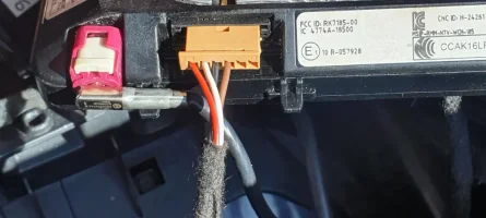

Only one new plug was required 4B0971978B.
Pinout is literally 1:1 almost plug & play;).
And links to all parts involved in this upgrade.
Another well invested €35 = £31 :thumbsup:

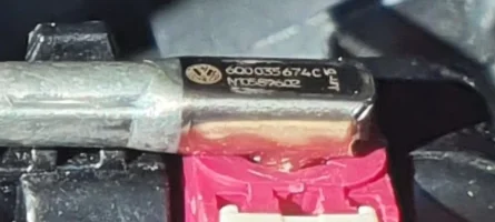

This is antenna cable part number
6Q0035674C
Would this work in. T6.1?
Looks like it does.
See the photo in the link below.
