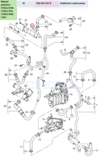

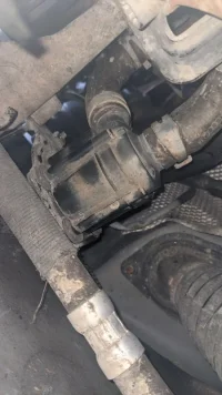

Apologies for dragging up an old thread. Can anyone tell me if this is the EGR coolant pump? Its the only thing that's making a noise when I run the output test above. Although, it makes noise as soon as I turn the ignition on.

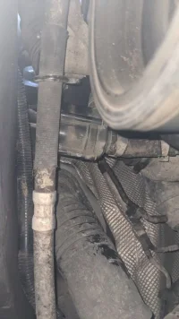

Picture below is through the right wheel arch looking up, near the bottom of the engine bay
CXGB 102 engine
Annoyingly can't see a part number on it.
Great stuff, thankyou. I was.....close. Right part number. Wrong pump.
And it's much easier to access!
