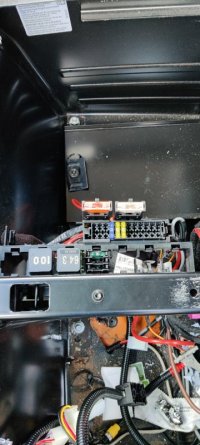

So I have had a look at other threads but couldn't find the answer, does anyone know what these wires/ fuses do under my passenger seat please!?
Its all spec dependant, photos 1 and 3 look like factory wiring/fuses and photo 2 with the corrugated tubing looks aftermarket
The three fuses in a row could be towbar wiring maybe ?
One of the cig sockets is normally fused from under the seat but again its all spec dependant
From what I have found so far I believe all the corrugated stuff is RAC stuff, but then when I get under there I am a bit worried about pulling stuff that might be for other things that I need. Is there anything under there that is needed for day to day running of the van? It has a towbar so I presume one of the fuses is for that. Is there any way of finding out?
You could buy a cheap multimeter and try measuring the voltage on various pins in the towbar socket. Try with lights on and off, indicators (or hazards) on and off. Then try removing a fuse to see if it is affected.

Black lead to the vehicle body, not the paint work. Red lead into the pins, one at a time.
