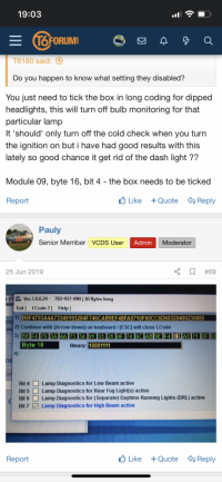

Try this . Bite 4 and 7. Cancel lamp monitoring on high beam and low/main beam. I bought Philips Ultinon Pro9000 H4. Gonna try to fit this weekend. If i have warning- will try to sort it out with VCDS
Fitted Philips Ultinon Pro9000 and had dash warning light for high and low beam. So after ticking bit 4 and bit 7 dash light gone. Thanks to Pauly
I’ve got LED low beam bulbs and have ticked the Bit 4 box but still getting a bulb warning light… any ideas? Robert has offered to look at a scan but wondered if anyone knows of any other reasons why this VCDS change wouldn’t work? I’m being impatient I know, it’s just driving my OCD nuts!
Could try disconnecting starter battery for a few minutes.
Another try would be to untick byte 16 bit 0 (presumably affects the way low beam is driven). Perhaps ticking also main beam diagnostics off via byte 16 bit 7.
Anyways - a VCDS Auto-Scan would be helpful - what is/are the associated fault code(s) for the bulb warning.
