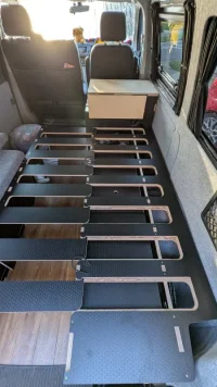

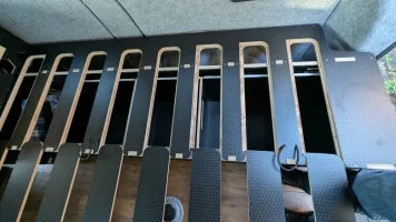

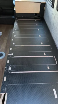

We have an awning kitchen set up and keep the cadac in the drawer above the fridge. i find it a pain moving the cooker and gas to the back door every time you want to cook. I have used the pull out for the jetboil and a quick brew up though.
We have barn doors and if you want something out of the pull out you have to unlock both doors to allow the pull out to exit the driver's rear door.
I think they may have modified the Torridon unit since we bought ours but as you'll see below, access in to the drawers from above is not easy.
I think the Assynt units might have better in van access.
