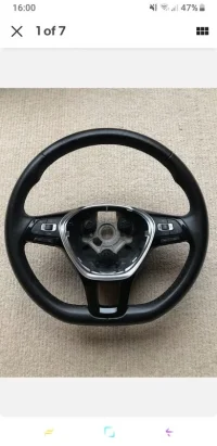

I've just fitted a polo mfsw, you need the correct polo airbag, although the T6 airbag looks the same - it isn't, it's a different fitment
I bought the one in the photo complete with airbag and it was a straight swap, I already had a highline though so button layout was exactly the same

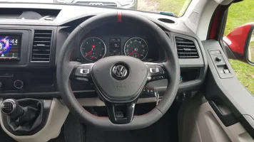

That looks ace! Did you get it retrimmed?
Do you remember whether your Polo wheel had a 2 pin or 3 pin airbag fitting?
I'm hoping there are 2 types of Polo wheel... one with 2 pin and one with a 3 pin airbag fitting - depending on model year, maybe? Trawling through the forums it looks like some will accept the stock bag. (This is mine.) Hopefully it will, or my 3 year old will have a nice toy MFS wheel to pretend to drive with whilst we're going along.... :)

That wheel will take a T6 airbag

Cheers, yes had it trimmed by Royal Steering Wheels, £170 all in
Definitely recommend
Yes, my Polo had 3 pin fitting, didn't realise that there was 2 different types
I tried my T6 airbag on it before I sold it on and it didn't fit
That's mine before re trim and without the airbag
Can't help you there, as I said, mine was a complete item so was plug & play

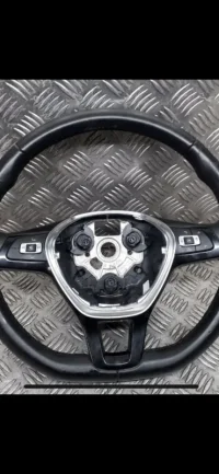

0A526D77-6EE3-4C00-8DEC-37F56ED4EED9.pngRead this post after purchasing a polo wheel - from reading I believe the one I’ve bought to be incompatible with a 2017 t6 bag as per the comments. - please could someone confirm, as I may be able to return it. Many thanks Andy
Reactions: mmi
View attachment 131323Read this post after purchasing a polo wheel - from reading I believe the one I’ve bought to be incompatible with a 2017 t6 bag as per the comments. - please could someone confirm, as I may be able to return it. Many thanks Andy
Your airbag will not fit that wheel.
