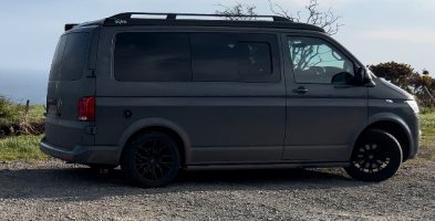

I can’t say I’ve heard of Arivo Ultra ARZ4 but my initial concern might be your suspension; campers often sit heavier at the back, causing the front to understeer, and your photo seems to show that.

Its the rake angle of the van all the weight is on the rear , you need to level it up !! ideally get some proper shocks in there too to maximise grip .
We all talk about camper sag affectionately as a joke , BUT these vans arent safe when the rear is 40 mm lower than the front !!

I really appreciate the time you guys have taken to provide valuable advice. I wondered what you meant about the sag at the back and how that was visible…to realise I wasn’t looking at the wheel arch and instead was looking at the bottom edge of the van it is very visible and quite alarming we didn’t notice (not sure a paddleboard in the boot makes much of a difference). What would the typical fix look like as I’d be happy raising the back end to give more clearance over different terrain and how quick can I book it in?! Would be good to discuss with you, Michelle
If you are convenient to us , we can assist with a quick fix to get the back up - or do a shock change as well (which needs more time obviously)
This is a common problem and the reason we do 60 to 100 a month , great results from the KONI shocks if budget allows , otherwise we can get the chassis levelled up and at least make the van a bit safer .
