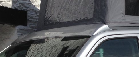

I don’t have a gap, I have a Reimo roof with a spoiler.

Here it is if you are not familiar with a Reimo roof, there is a proper spoiler bonded to the body over the windscreen.
There is a reason why Reimo and SCA are preferred by some reputable converters.

The spoiler on the front is standard Reimo installation if that is what you are referring to?
Otherwise I have used 20mm of self adhesive acoustic foam above the OEM headliner and made a 40mm upholstered foam pad that’s a tight fit in the poptop access opening.
