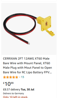

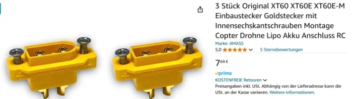

Thanks. Very neat but never soldered in my life , that's a shame. Think it'll be male to male plug , xt60 lead to mc4 l and then mc4 lead to bare lead to go into the victron. Cost me a fortune in leads .
perhaps something like that? Perhaps with this no soldering is needed, perhaps just crimping. It depends on your setup I think, e.g. how far is your port away from the victron.....
