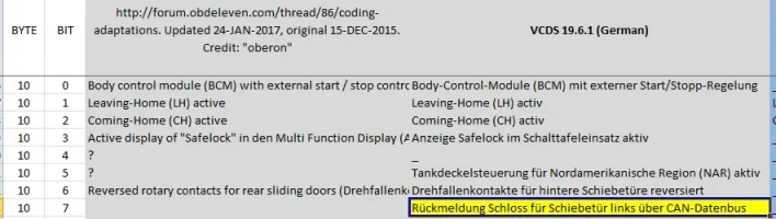

German VCDS suggests byte 10 bit 7 to be the same for the left sliderLooking at the coding here VCDS codes list
We can see byte 1 bit 1 = Confirmation lock for right sliding door via CAN data bus

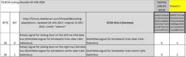

EDIT:
Supports the theory...This is my factory BCM and almost virgin coding.
7E0937090 - BMC PQ25 Max4 H80 0736
B8FE79304AE3349393288FC47E8A9EF4FDA469F960C86960320403BF0840
