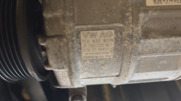

Still from the video showing part number
Number is the same as those above but N suffix (not B or F)

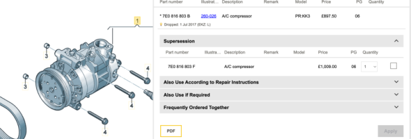

Yes, I sent you an illustration as I don't know your engine model or vin.
You might be able to find a s/h compressor and just swap the pulley.
