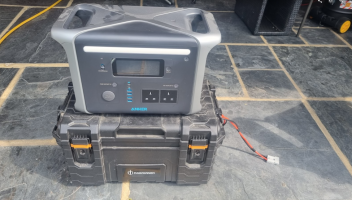

but there is an easy fix - fit a lithium battery alongside as a storage buffer battery, you can double, tripple, quadruple, . . . the run time of the PPP.
and if you need more, then you can fit solar or a dc-dc charger to recharge the storage battery.

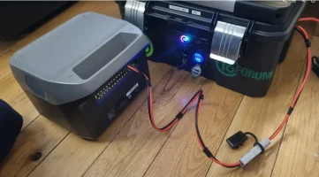

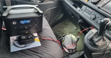

Storage battery 160W charge Hack:

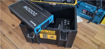

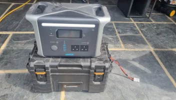

build your own battery box:
building a bigger battery box:

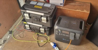

building a Monster Portable setup:

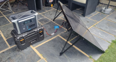

so the next step was to add a second storage battery.
using a separate solar MPPT, victron in my case will dump power into the storage battery.
the cleaver thing with the storage battery is that the PPP can now recharge 24/7.
where as with solar it can only recharge during the short sunny day window.
so when my PPP is low at the end of the day - it keeps charging all night.
the following day its normally 100% charged.
this all depends on the size of the PPP, the size of your storage battery, and size of your solar.
but as above:
in my testing using any of the PPP`s i have.
a 100ah lithium storage battery and 200w has allowed me to be fully self-sufficient.

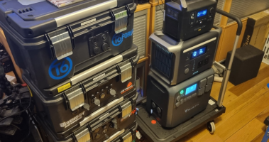

I've run loads of different setups. . .

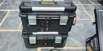

the 160W 12v fast charge works realy well,
plus the storage battery box can be used stand alone in its own right.
this was a good setup that see us through a week easy . .
there are many benifits of a PPP.

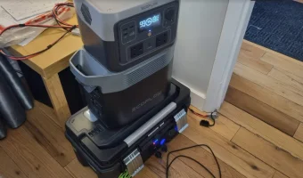

at one point i had a stack of four storage batterys all linked together. . .

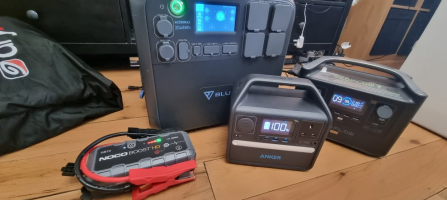

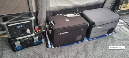

I've had the bluetti ac200max as well . . .
this see us through a week at silverstone. . .

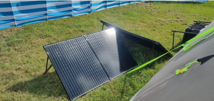

just dont forget the solar. . .
this is 2x 200w renogy suitcase. . . at silverstone.
