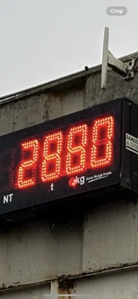

So i thought i had better weigh my Swamper conversion on my T30 (i had noticed it wasn't as quick as pre conversion!! ) came in at 2880kg! with water tanks empty and driver. so add passenger, full water tanks and a bit of food and were at 3000kg thats before i add toys and hang 2 ebikes on back etc.

Our swb 4M camper weighed in at 2640, for normal use, with two people and full fuel.
When we were fully packed for a month away in Norway, we weighed in at 2880, so 240 kg for a lot of food/drink/15 litre fresh water/ extra gas/clothes/bedding/etc etc,
we have a T32 so have some spare kg if we take bikes and paddle boards away.
Engine is 150 and seemed perfect for the van fully loaded, I’m about to add just the engine plate as I know the weight does add up, (going to Iceland next year whoop whoop)
I’m lucky that our local tip allows you to use the weighbridge for free after hours, they leave it switched on permanently,IMG_3055.pngIMG_3054.jpeg
