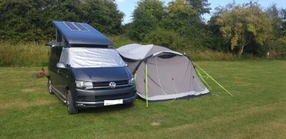

Hi All, Just an update regarding the panels, currently out in Hampshire for the weekend camping ...
Working really well. The Vinyl Wrap seems to be holding, no peeling round the edges or bubbling. I used two methods on sticking the panels down; I used 3M RP45 Tape generally on the underside with some careful postion to allow airflow sideways underneath the individual cells and then I used some sikaflex on front edge and back to secure those edges and allows no airflow underneath. Seems to be holding well - touch wood.
In terms of the new panels, they are wired in parallel into a Victron MPPT which controls all the solar side and has the handy bluetooth to monitor the input - really handy to know they are actually working and doing what they are meant to!
Yes, I know I need to peg out the awning properly - but I have a cider in hand so it will have to wait until the morning!
