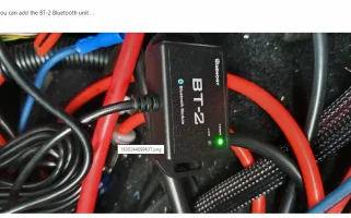

i would also sudgest getting the Bluetooth unit that goes with the MPPT charger . . . with that you can adjuest the output and change the setting, and monitor the output etc. . . you cant do that with the blue uni9ts..

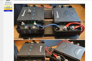

have a look at my new Renogy DC-DC & MPPT with the BT2 and APP.
