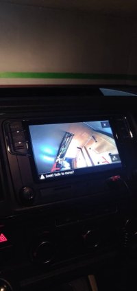

Well, a kind of unexpected that the fault is still there. I'm wondering if it's actually the fault that prevents the headunit to show the video. Are there any known coding options available? Are there any output tests available in VCDS, e.g. something related to video - which would just "force" video onto screen?When I untick byte 03 bit 6 the fault does not go away. I even tried clearing the error and it would still come up later. However, the reversa camera screen did stop showing when I put the van in treverse.
