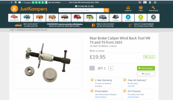

more info here:
If JustKampers are selling that tool it would suggest that a single motion (be it clockwise or anticlockwise) would do both sides.
I'd like to know for sure myself tbf as changing pads is something I've always done myself but have never changed rear pads that need a tool like this. If you do need both tools does anyone know which side is clockwise?
