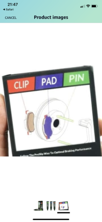

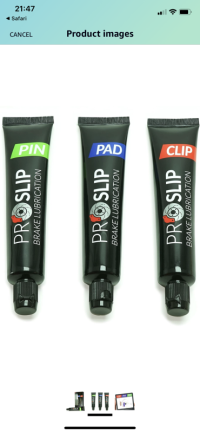

Yea a lick of paint wouldn’t go miss . Managed to do it earlier on, I bought grease, Proslip grease, contained 3 different lubes, one for the pins, one for the clip (that the pad sits in) & one for the back of the pads. I removed cleaned & lubes the slider pins and brought the pistons out by gently applying the brake & lubes the piston before winding back in. It’s done the job. No grabbing at All. Thank you all for your help guys, just for the MoT now .
