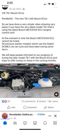

I saw this from pendle when I was looking into it a while back, basically if your engine bay looks like this and has the connector block at the top - circled, I think that’s a Bosch version as the Delphi doesn’t have this apparently…
