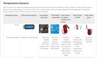

The victron temp sensor ( blue) works on the Smart Shunt & The BMV712. (and others)
BUT,
Only the BMV712 has the relay output
The Smartshunt will generate alarms via VRM ( if online ) or local on the APP when in BT range.
BUT,
Temperature Sensors [Victron Energy]
