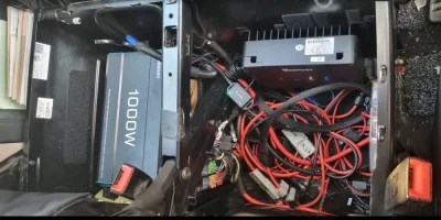

Well I have my battery 100A LFP battery & Renogy 1000W inverter in the opposite positions but I wouldn't trust Renogy cables TBH.
The short ones that came with the inverter get very hot @ the crimp terminals in my testing.
I made my own up using cable & crimp lugs from 12voltplanet based on their current draw & length and fused appropriately. They are miles better & stay cool.

Shorter cable runs for a high current draw like an inveter make good sense, but my battery DC-DC charger/fuse box & amp were already under the drivers so I had to really use the passenger under seat space in mine for the inverter.
This also means it has plenty of air circulation for cooling the inverter (single seat base) & the inverter 230v socket is on the rear of the seat base as thats how we use it.

" Renogy 1000w inverter under drivers seat, and connect to the 160ah lithium which will be under passenger seat, " - this is how i have mine setup.
you need to use super beefy cable, as above use the cable guide.
1000w full load will easily pull 100A/120A . . . so cable for that and fuse accordingly.

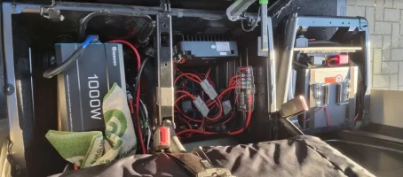

In run the 1kw Renogy inverter in the van 24/7.
Due to size it was the only one I could fit in the twin seat base.
It runs everything, and even stuff that other brand inverters don't like.
