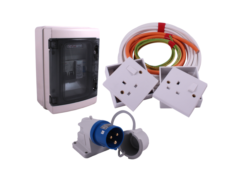

Kit is shown in a photo in post #14 in this thread. It show you how to fit later on.
There is other threads with descriptions of similar setup, one that comes to mind is @Deaky 's build thread.
Complete kits can be bought:
