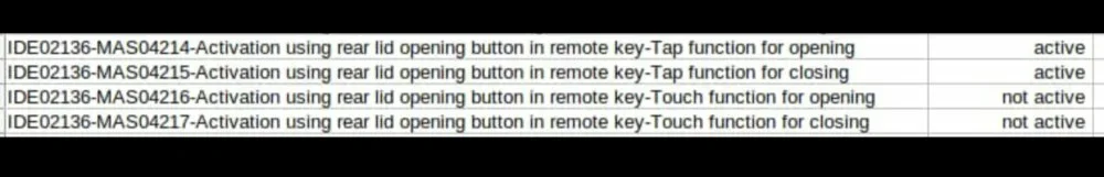

forgot to say the kit is working off the keyfob to open but not to close (yet) maybe a coding thing but not seen anything for it yet on VCDS.
I am not sure what kind of configuration is possible with your kit.
But to open and close the tailgate with the remote on the VW OEM setup you just need to apply the following adaptations to your tailgate control module.

I have the factory fitted electric tailgate and side doors but I can't get the tailgate to close with the fob, is this a VCDS option as per video or can it be done with Carista ? Thanks.
You need to apply these adaptations ---> Retro fitting powered Tailgate???
