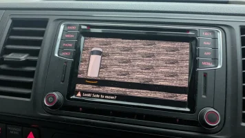

Hi I bought a T6.1 campervan last September that came with a reversing camera. The van had to go to the garage and in the course of the work being done they had to disconnect the battery. When I got the van back the reversing camera now doesn't seem to be working and I stead I get a grey fuzzy screen. I took it to my local garage to see what the problem was and they said I needed a new camera. Before I fork out for a VW reversing camera and I just wanted to check that nothing else could be done. 1000009190.jpg

Assuming it’s OEM or equivalent.
The reversing camera has 3 wires +12V, reverse, GND on one connector + the video signal coax on a Fakra connector.
If any of the 3 wires were not present then the camera wouldn’t operate. It would display a message saying camera unavailable when you select reverse. I had the message appear intermittently because I had a dodgy +12V (now resolved).
As you get a fuzzy image then the culprit will either be the video signal coax or the camera itself.
