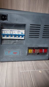

Does anyone's Revolution Ricos conversation have mains 240v to leisure battery charging?
Predictive text --- "charging"
Ah OK.
So are you saying that your conversion does not have a mains charger? That would be very unusual.
Can you post some photos of the electrics? Do you have an EHU (mains hookup).
Sorry, I'll explain a little more. The EHU hookup, when plugged in and switched on, does seem to run the conversion electrics, fridge, lights, 240v sockets etc. But it does not recharge the leisure battery. Only the engine, when running, recharges the leisure battery via a Stirling unit. I have swapped fuses on the mains panel and it makes no difference.

Yes i have o
i have the Revolution conversion. It had the Sterling B2B and Sargent EC power distribution and charger. The Sterling got replaced by a more compact less cumbersome Victron. I removed the internal constant voltage battery charger from the Sargent as tge Leisure Battery was an AGM battery.
Not familiar with your Power Part pms but I would guess it would have a constant voltage charger triggered by the on off switch. Do a volt meter check on the LB when you are connected to mains. Should get a reading of 13.5v approx. if your LB is agm you should bypass the charger as i did.
Sorry didn't realise I had a reply. What does the Sargent look like and where is it likely to be postioned please?
