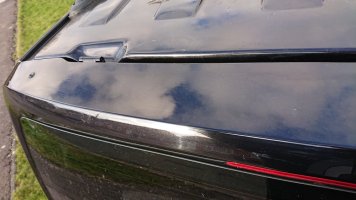

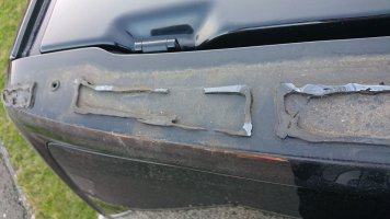

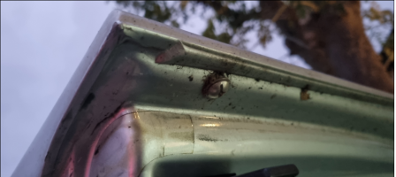

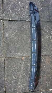

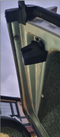

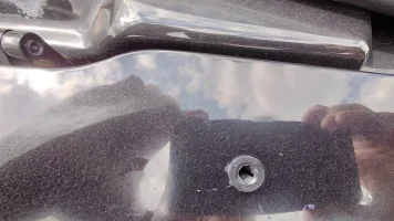

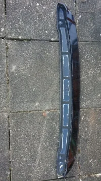

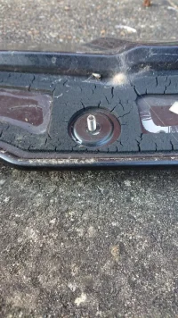

Posting these in case they are useful to someone else as I struggled to find this info.
Factory fitted spoiler on my T6 Highline. As noted by others they are bonded on, with two metal locating pins on either side.
Mine self detached in the end which saved any work with a heat gun and fishing line
View attachment 148112View attachment 148113View attachment 148114View attachment 148116

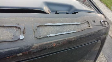

Thank you for the photos. Were you able to clean up the tailgate ok after removal? I'm thinking of taking mine off but worried about hideous eyesore underneath. Thanks very much

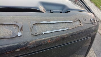

Mine's a factory Highline spoiler on a 2016 (tailgate) T6, the spoiler came loose and I removed it with fishing line as it was insecure.
I had none of the bolts / locating lugs, nor did they use what looks like double sided tape on the images above, just the black bonding stuff, which as everyone knows is a nightmare to remove.
Still making my mind up whether to refit it or just leave it off.

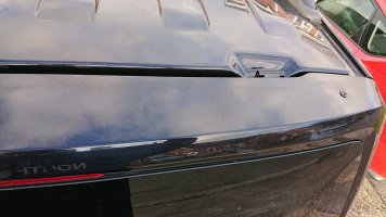

What did you put in the hole either end ? Roof blanking bolt fit ? Thinking of taking mine off but worried about causing any damage
DSC_0057.JPGI didn't actually do anything, I've just left the plastic insert with a hole in the top of the tailgate.

Be aware that if it's a factory fitted tailgate spoiler you will likely have a locating hole drilled at each end of the spoiler. The factory fitted spoilers have threaded locating pins.
