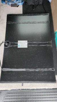

I don't know if it was just because I chose to remove my panel on one of the hottest days of the year or some other nefarious reason, but, when I cut the panel off, where I had laid the bead of panel adhesive on top of the vinyl, the adhesive beneath the vinyl was particularly gooey and was the weak point where the nylon string I was using to cut through the panel adhesive chose to cut best, it removed the strip of vinyl beneath the panel adhesive and left the gooey glue beneath.
The rest of the vinyl came off as I would expect, clean and pretty much in large pieces.
Where the panel adhesive has stuck to the solar panel itself (apart from the bit where the label was for some reason) is still well stuck, to the point that I'm going to have to use a sharp metal blade to remove it so I can reuse the panel elsewhere.

The panel removed..
The EB25 has stuck well to the vinyl but the vinyl adhesive has weakened..
Apart from one of the edges? The vinyl there seems unaffected and I cut through the EB25 to get it off.
