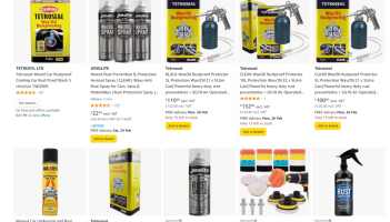

option #1 - Amazon.co.uk : tetroseal wax/oil car rustproofing easi-sprayer applicator
option #2 - https://amzn.to/4bJHEfP & https://amzn.to/3Tas71r
option #3 https://amzn.to/3OTlQER & https://amzn.to/3Ib9jc6
