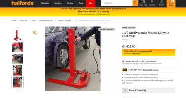

I think that is an unauthorized way of using a single "mobile car lifter"
There is normally four of them, placed at each wheel.?
And together the form mobile four post lifter.
Mobile as they can be rolled our the way when not needed, and adapted to any wheel base.
I'm fairly sure that it not an approved method of using them .?
Judging by how much my pop top creaks I wouldn't fancy have my van lifted at one front wheel like that
or maybe not?
Description​
Offers fast, easy lifting, with or without an air supply. Fitted with air/hydraulic motor for easy operation or can be raised using foot pump. Includes adaptors to lift via wheel or body. This specifically designed piece of equipment is a perfect addition to any busy workshop or repair centre wanting to raise a vehicle off the floor quickly and safely. Can be used for lifting cars, 4x4s and vans. Vehicles can be lifted from the side, front, back or wheels with supplied adaptor. The unit offers significant assistance with bringing vehicles into an ergonomic working position. Ideal for a wide variety of applications including welding, grinding and painting.
Nope. Its 100% what it was designed to do.
