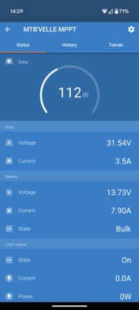

Tomorrow when the mythical sun returns, I'll see if it diverts any to starter while bulk charging the leisure. I don't think it does, but I'll check and put the result here so the information exists for others.
That's one advantage of a big panel, it's been raining today with barely any sun and I've still had between 13 and 30w from my solar, enough to charge it up a few % and keep the SB topped up. About 8Ah worth + the constant 0.5a draw I have in the van.
