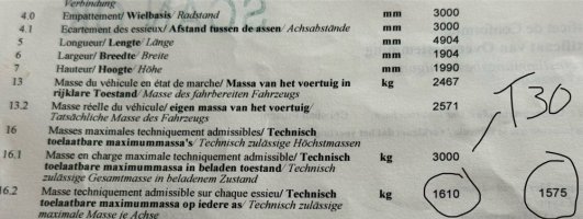

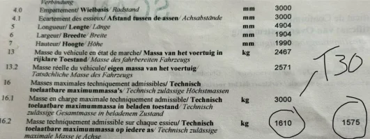

Are these the right part numbers?
Front 8705-1392
Back 8205-1009
These are correct for T28/T30 and what I used in mine. T32 front shocks have have a different hub attachment. Check out weight plate from under the hood:
Not sure about Koni parts for T32, I think I saw some 3rd party adapters being mentioned somewhere
