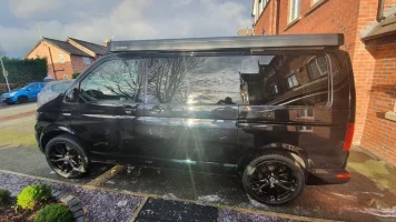

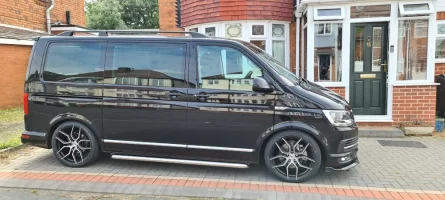

Show us your 20’s
Inovit torque.
Front 8.5x20 ET35 245/45
Rear 10x20 ET40 275/40
All T32 rated and a great price.
Inovit do loads of great styles in 20 at 880 kg load, staggered or not.
Koni/H&R coilies about half way down. The ride is sublime!

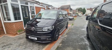

Still haven't got them yet in not 100% on the design of them
Are they Trapezoid side bars @Jayjmac? Can I ask where you got them matey?
