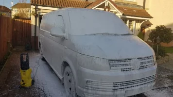

I just stuck in 100ml and left for 10 mins, seems decent, better results than AG polar blast.

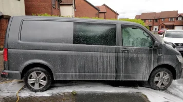

What lance are you using lad?Had my first go with snowfoam - autoglym polar - and think I had too thin a mix though, will have another go next week
It was my mates nilfisk pressure washer with this that he's gotWhat lance are you using lad?
Definately something not right there. Twist the nozzle on the gun to open the blade gap right up. Then adjust the air inlet to get best result. Stand well back and at an angle of about 45 degrees to the van. 200mls of polar blast or magifoam in a 1 litre bottle with warm water added, should give you this result. Well it did for me....
