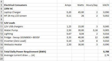

To decide what capacity you need, you need to do a power budget - and the biggest consumer (assuming you don't have an inverter with lots of 240V devices) will be the fridge. Compressor fridges can use anything from around 0,3kWh to around 0,8kWh dependent on ambient temperature, insulation, contents and size. It is worth getting a watt-meter (https://www.amazon.co.uk/Diymore-Analyzer-Detectorm-Consumption-systems/dp/B0B96F6RH8) and wiring it in series with your fridge to find out how much it uses over a typical weekend away. Whatever it uses needs to be available, in Ah from the lithium battery you choose - with a bit of extra capacity for all the other 12V loads you have.

My energy budget for my van looks like this ....
... and as I decided to stick with the AGM leisure batteries fitted to my Ocean, I ended up with 310W of solar on the roof. I am in central/southern Europe so it more than covers my energy usage between April and September when I use the van most.

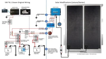

Our T6.1 was ordered from new as a panel van with factory fitted 2 captain seats and leisure battery under the passenger seat - van was then converted to camper with Victron Blue Smart charger 12v/10a added as part of the electrics. So where does that leave me regarding a DC to DC charger if I’m now changing LB to Lithium- is that now more complex?? Apologies if that sounds like a stupid question

If you’re running a factory leisure battery then it’ll likely be hooked up via a simple relay - you should be able to verify this if you look under the passenger seat. If so, it’ll be charging to no more than 80% full so you might want to consider a DC-DC charger. You’ll need one of these anyway if you install a lithium battery, you can’t connect these with a relay.

I don't have access to a schematic showing a panel van with leisure battery, but as already mentioned, it will almost certainly be connected to the engine battery via a relay operated by VWs Special Vehicle Control Unit (SVCU) - maybe it's a Battery Control Unit in your van, I don't know. This second battery will also very likely have a shunt attached to the negative terminal which allows the SVCU/BCU to estimate the charge level - which it tries to hold at around 80-90%.
The batteries and smart alternator are part of the emissions control system on modern cars (and vans). What this does is when you accelerate, the smart alternator stops producing power, and the vehicle electrical system is run from the batteries. This removes alternator load from the engine and saves fuel during an acceleration. When you decelerate, the smart alternator dumps power into the batteries to give additional engine braking and to recover energy - storing it in the batteries. In order for this to work, the system tries to keep the batteries around 80-90% charged to allow for recuperation. The other action of the smart relay is to disconnect the leisure battery during an engine start so only the starter battery and wiring have to deliver the load required to start the engine.
Obviously, for a camper van, 80-90% charge is not what you want which VW recognised and in the versions with a Camper Unit (display above the rear-view mirror) there is a Max Charge option which you can switch on - this changes the behaviour of the engine, the idle speed is raised, start-stop is disabled - and the batteries are charged to 100% ... normally switch this mode on about an hour before arriving at a camp site.
My wiring looks like this ... your van is probably the same minus the Battery Charger and 3rd battery.
If I were you, I would look through the posts from @Dellmassive for an appropriate diagram and explanation relevant to your setup. Basically you isolate the Lithium leisure part from the AGM based engine part with a DC-DC charger running a Lithium charging profile. This will charge the Lithium batteries with the right charge profile but using the alternator as the power source.
