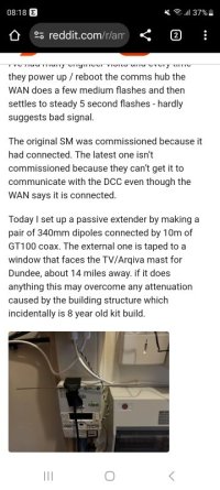

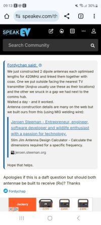

Some guy in a similar situation has come up with a 'fix'......
I may try it.....
But where do I get the hardware?
I have seen that done on other forums, with varying results. Worth a try. As mentioned previously the whole system is a shambles, shouldnt require the homeowner moving things (like I did) to get things working.
