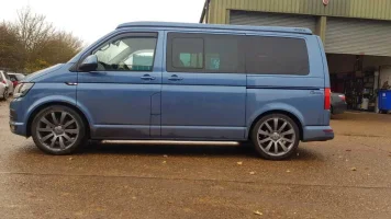

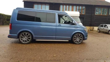

Here is mine - Set as high as it will go for now

I have just fitted the ultras to a t6 t32
Did you remove the large rubber washer on the rear above the original spring?
I must say they are very smooth. No crashing. Well impressed
They way the shockabsorbers adjust in height is brilliant idea. It gives them more travel than other units I have seen and they are smooth.
I've only gone down 50mm but I have another 100 to go if I want!
Just the fronts to do now
