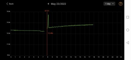

I had a go at charging and leaving the battery without it being connected to the van (removed the negative terminal), here are the graphs. The second is 45 minutes after I took it off charge. Screenshot_20220523_174940_com.dc.battery.monitor2.jpgScreenshot_20220523_184837_com.dc.battery.monitor2.jpg
Dead battery? If it’s been as low voltage as you said earlier, then damage is likely. Mine says don’t discharge less than 12.0v.
Thanks, I seem to be in a chicken and egg situation, I need a new battery, but it's likely that whatever is up with my van will drain the new battery to below 12 volts, probably sooner rather than later.

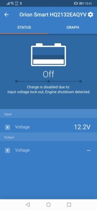

Did you get a chance to have a look at the remote on/off wiring and the app settings? Your answer might be there.
Thanks for sending. You’re definitely not using an IGN+ / engine running signal as the terminals have a jumper wire across them. This means you’re relying on the auto sensing. Your settings look right compared with @Dellmassive ’s post here:
Your auto sensing is set to stop pulling power from the starter when the starter voltage gets down to 12.5v. From your earlier posts, your voltage has dropped below 12.5v, so (assuming Victron isn’t faulty) that makes it look like the DC-DC charger isn’t the reason for the drain.
